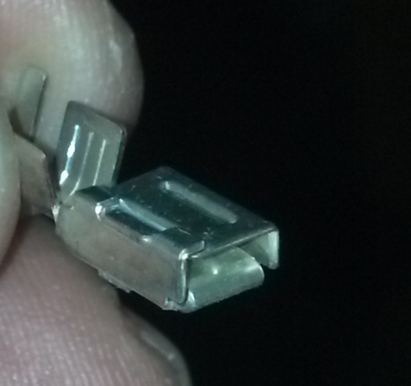

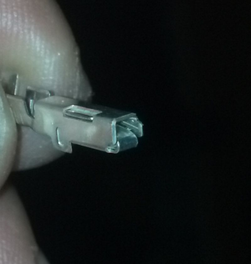

I'll start with connector pins. You can order entire kits with crimpers, heat gun and 10# of pins. Part numbers are listed in tsb-00-099. There's an accord one I'll post later for pins used in stuff like air bag connectors.

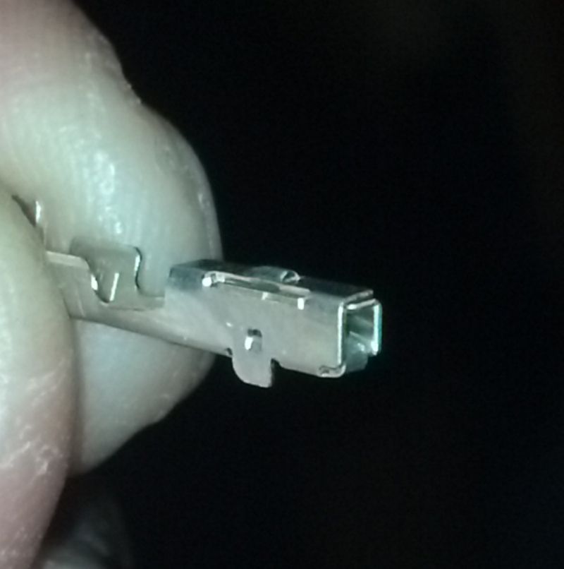

I bought the connector pin replenish kit for fixing the broken wires in the connector between the door and fender of my 97 SH.
Below is a list of sizes for each of the pins that come in p/n 13CNNA-3
^^ the list of items it comes with.
Dimensions are in mm
L = to point of crimp uninsulated portion from tip
# 001320A
L = 7
W=2
D=2
^^ # 001330A
L=12
W=3
D=2
^^ # 001350
L=11
W=3
D=2
^^ # 001360
L=10
W=2
D=1.5
^^ # 001370
L=7
W=2
D=1.5
^^ # 001380
L=9
W=2
D=3
^^ # 001400
L=8
W=6
D=4
Parts 001340 and 001410 are insulators.
001340 is 1mm ID x 4mm long
001410 is 2mm ID x 8mm long

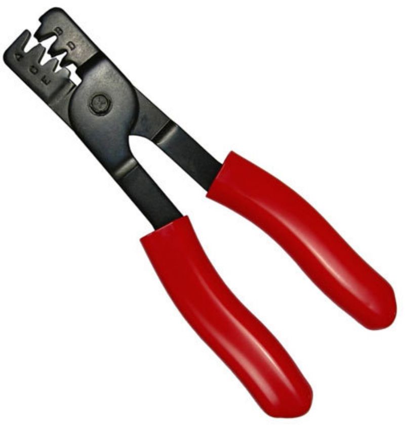

http://www.repairconnector.com/heavy-gauge-crimper-for-weatherpack-terminals-and-connectors/
^^ Honda wants $105 for these

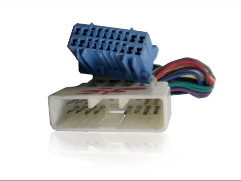

http://www.cd4car.com/adapter-harness-for-1989-1998-honda-accord-prelude-odyssey-civic-crv/
Got a 99-01 radio, but 97 or older car? Pre made adapter.

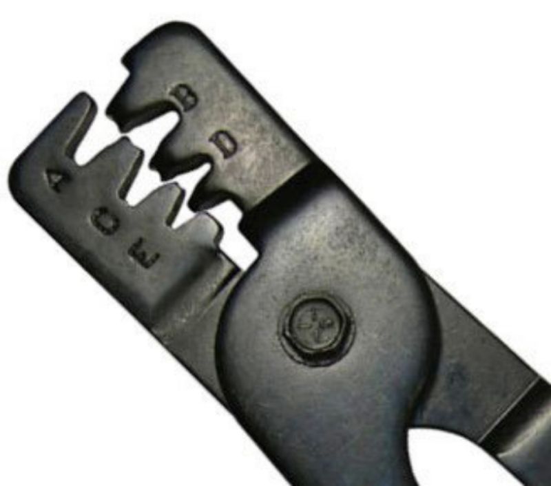

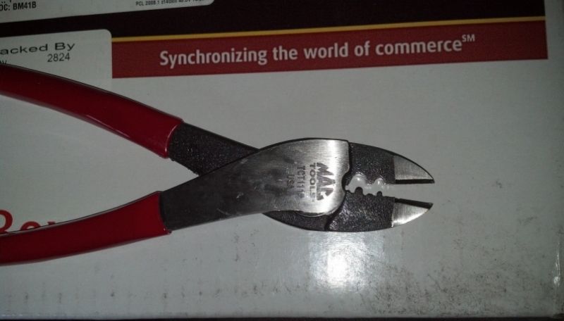

^^ Mac Tools TCT111P

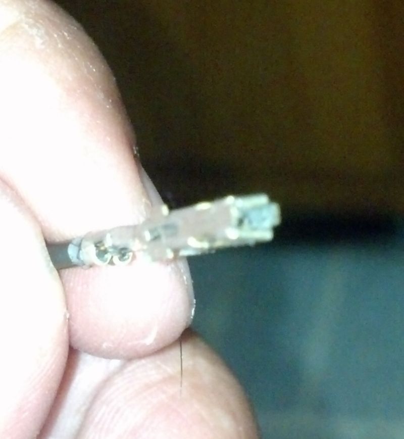

I'm using these to pinch the wires to the pins used in the door to car wire harness connector.

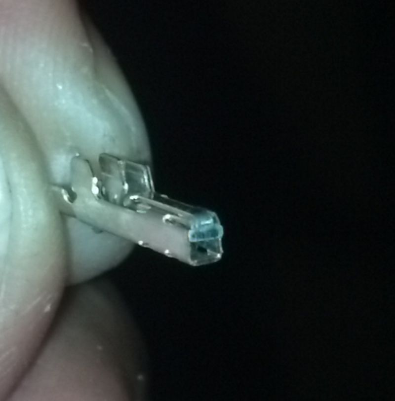

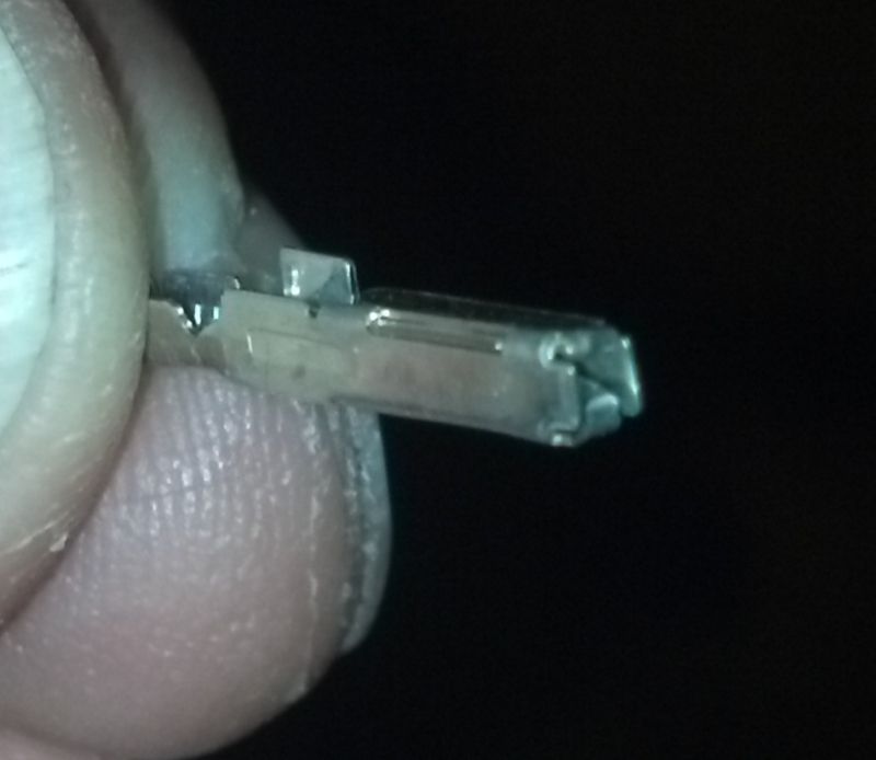

^^ Test crimp.
Left was via the Mac tool. Right is a factory pinch.

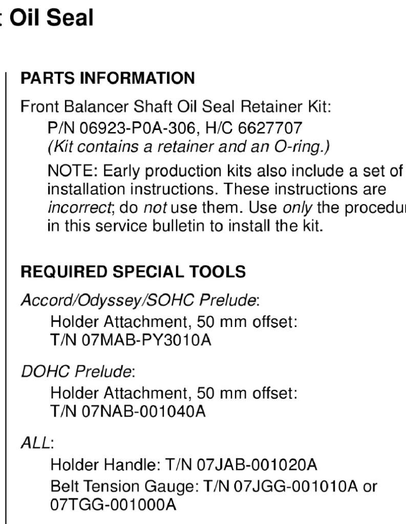

The balance shaft oil seal issue solved.
TSB 00-073 is the Honda way to solve the 94-97 issue. (Thanx for the tip pz member Jamie) Now I suppose the same part applies to 98+ motors as well.
https://www.google.com/url?sa=t&source=web&rct=j&ei=XwH-VNXGI--IsQSz0IHQDQ&url=http://www.driveaccord.net/forums/attachment.php%3Fattachmentid%3D10186%26d%3D1197834002&ved=0CCIQFjAC&usg=AFQjCNEZ-YnxWlFFZp5RG-fanVm_XBMSGA&sig2=cLVjrLVd9QTZpA4XXvh8Hw
^^ a link to download said TSB
https://www.google.com/url?sa=t&source=web&rct=j&ei=XwH-VNXGI--IsQSz0IHQDQ&url=http://www.autosafety.org/sites/default/files/HondaSeal.pdf&ved=0CBwQFjAA&usg=AFQjCNHN4XEHspCgMI-X4Twd3ZNIdi30vQ&sig2=zveMhvVSB1LE4i6CgE17qQ
^^ a backup link.
http://www.am-autoparts.com/Honda/Odyssey/transmission-and-drivetrain/AM-11695007/582732.html
^^ where to buy one with a 10 year guarentee.

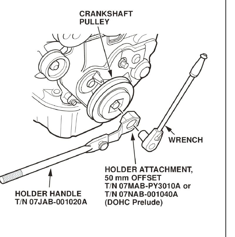

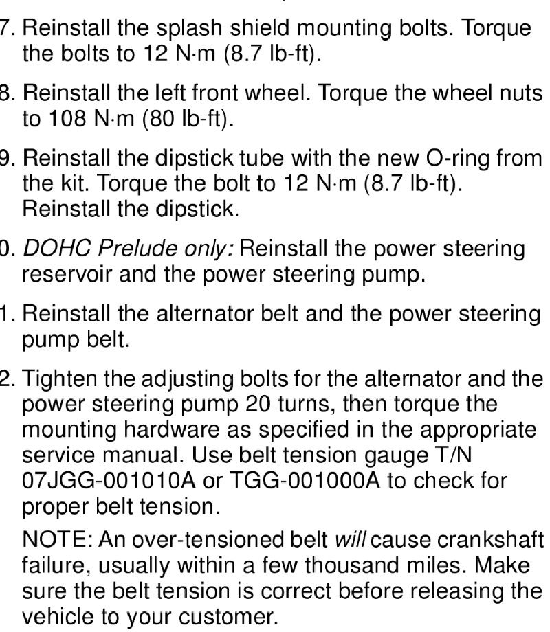

some pix of stuff to know:
^^ the official Honda pulley grabber p/n's
^^ the official Honda belt tension checker p/n's
^^ retainer kit p/n and recap of official tool p/n's
