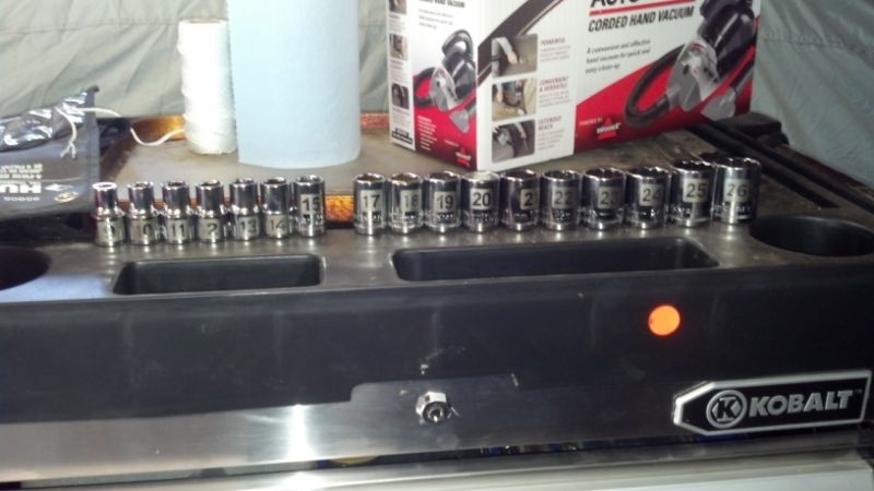

« Reply #29 on: April 06, 2014, 12:24:46 pm »
^^ This...
And went to sears for some 1/2" drive metric sockets.
A couple of other tools were purchased as well. And checked prices for decent torque wrenches.
Ima check the numbers for the max torque required. If we need a 1/2" torque wrench, so be it. But if 3/8" will do do I'll put the $ a half inch would cost into a better 3/8 unit.
