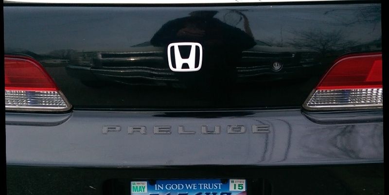

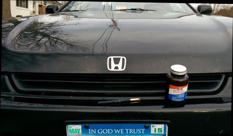

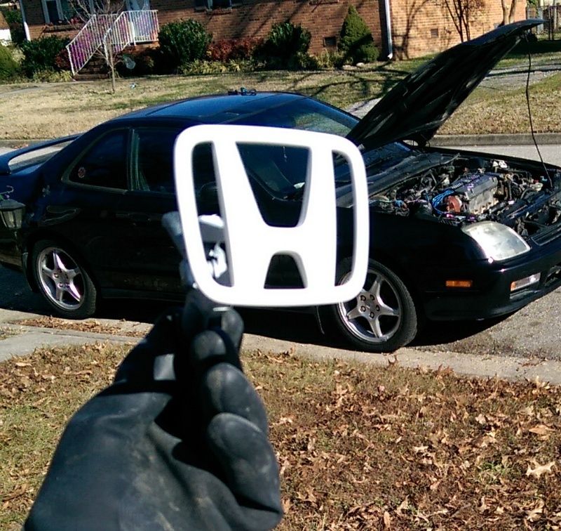

Drove the $h1+ outta ole bessy for about an hour today. She ran flawless. Oil lamp is dim, not bright.
Soooooo, another succesful repair leads to another cosmetic mod.
^^ emblems coated with white, clear, more white and more clear.
Day later edit:
^^ installed using rubber cement.
Very sticky, very weather resistant, and most important, very easy to remove later.
