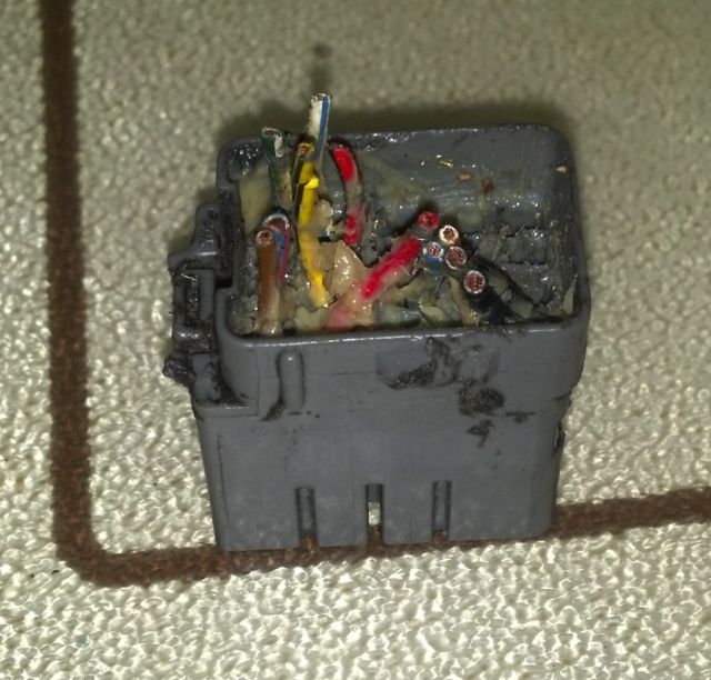

While the car is parked I started investigating non working items in the driver side door.....
Here's what I found ⇩
^^ Ugh! I wanted to cry. But when the going gets tough and all that...

All sticky and gooey messy like.
^^ to this

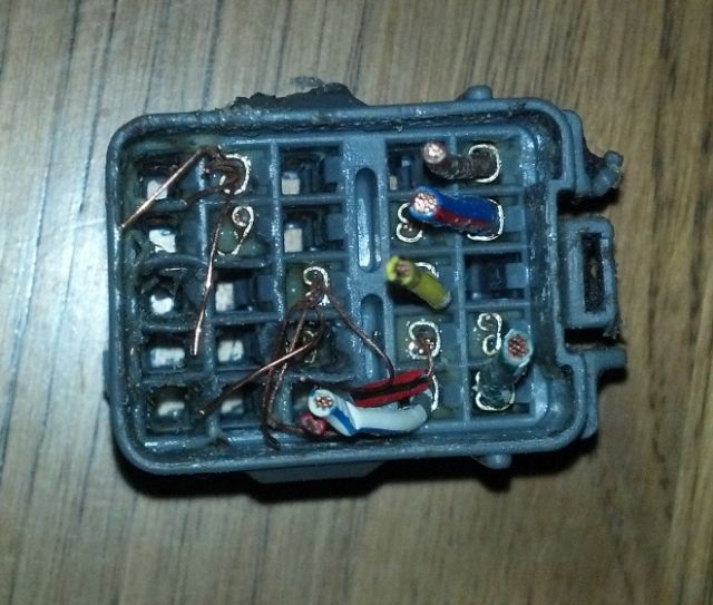

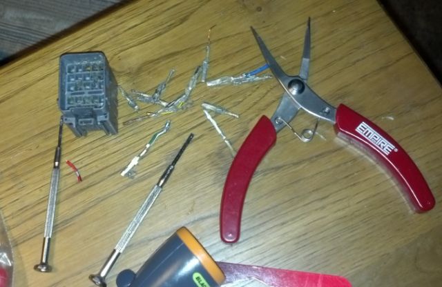

After downloading Honda tsb 00-099 (an acura how to fix broken wires in terminals) I dialed in a technique to removing pins. The hope was to make this repair still attached to the car.
I got a couple of pins out and more wires broke inside the pins. So it was cut off and brought indoors.
^^ then this
That grease made it difficult to see what was happening with the locking points. More wires breaking instead of pins coming out.
A good dose of cleaner from radio shack helped.
^^ magic in a bottle. $10.99

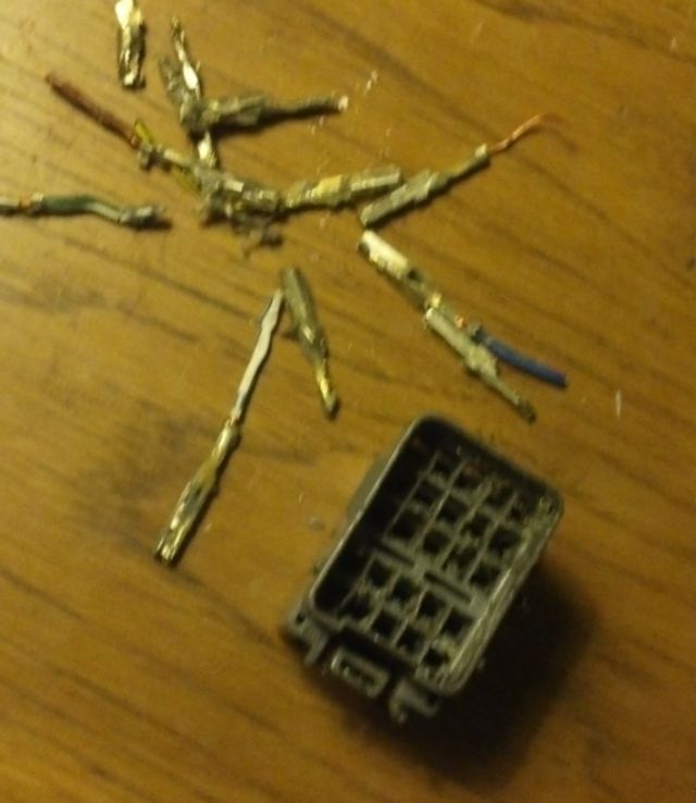

^^ currently this

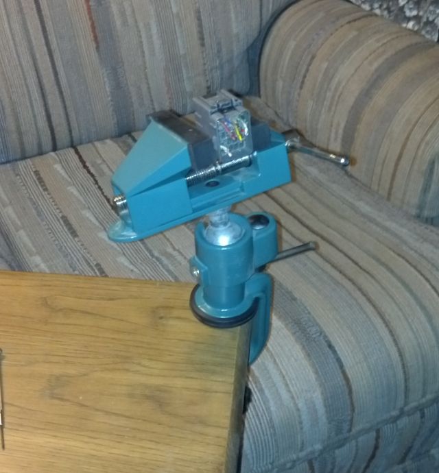

Finally got all the pins out. I drilled out the last couple that were all mangled and broken with a 3/32" drill bit and picked out pieces.
^^ the tools used
^^ the vise, an easy chair and lots of light.
^^ and the borg gear

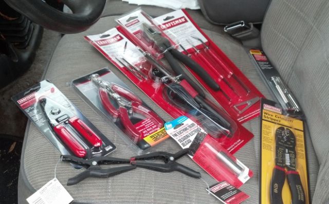

The jewelers lenses and clip on light are well worth the less than $10 investment. Light from sears and lenses from harbor freight.
^^ repair tools in stock
A soldering iron (900° max) for tight spots, various aids for soldering and good wire strippers.
They were all on sale too. About $50 total.

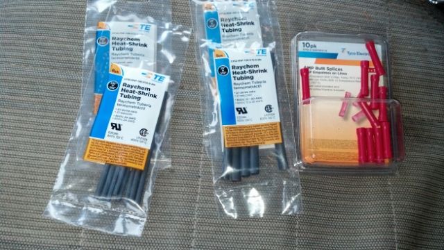

^^ shrink tube for final touches.
Differing sizes are incase the skinny stuff don't fit.
Now I await the Honda connector pin replenish kit (p/n 07XAX-002000A), that Honda calls terminal update kit. It's 25 of each of the nine sized pins they use. About $75 from hondapartsnow. It was either that or 18#'s of pins, a heat gun and other stuff for $275+..
