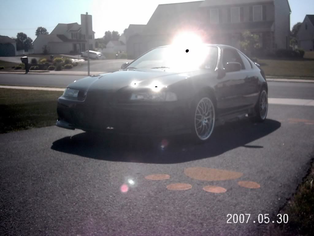

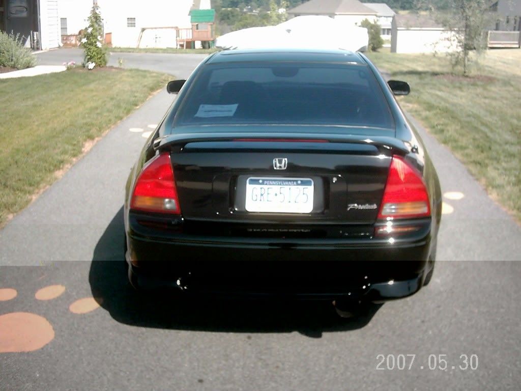

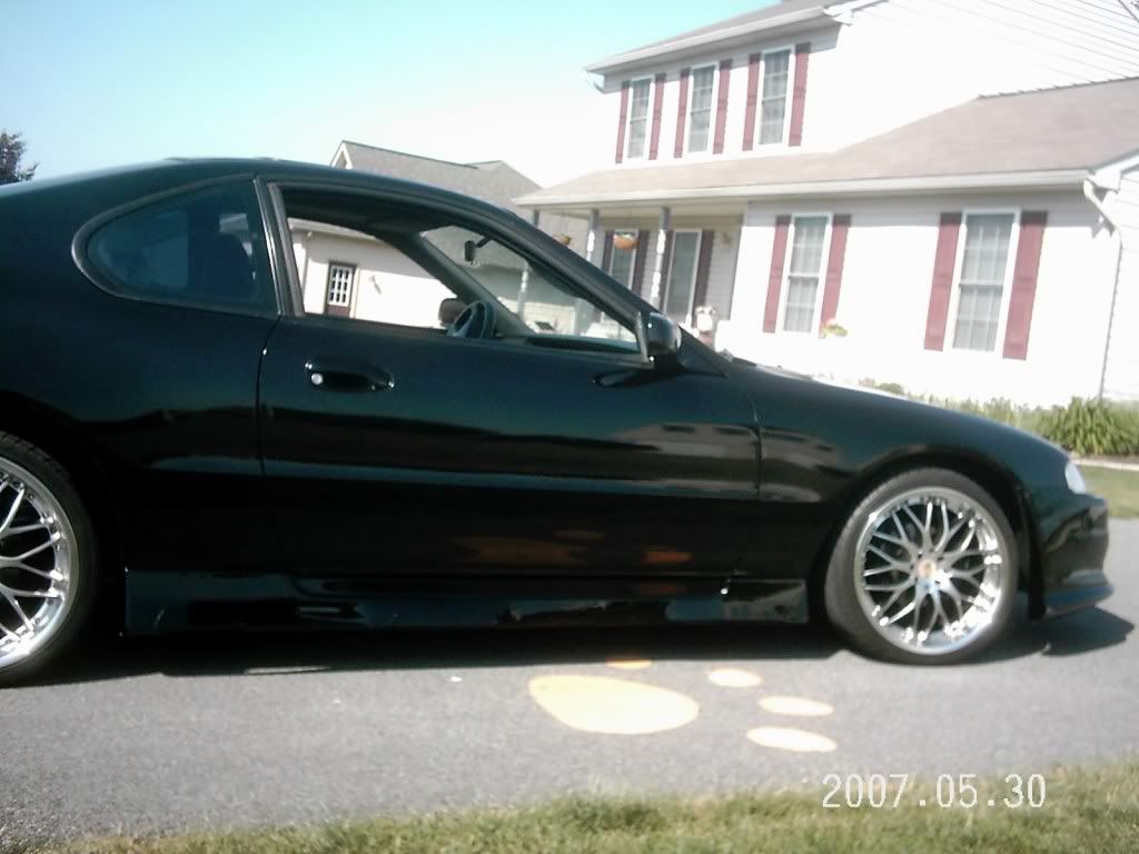

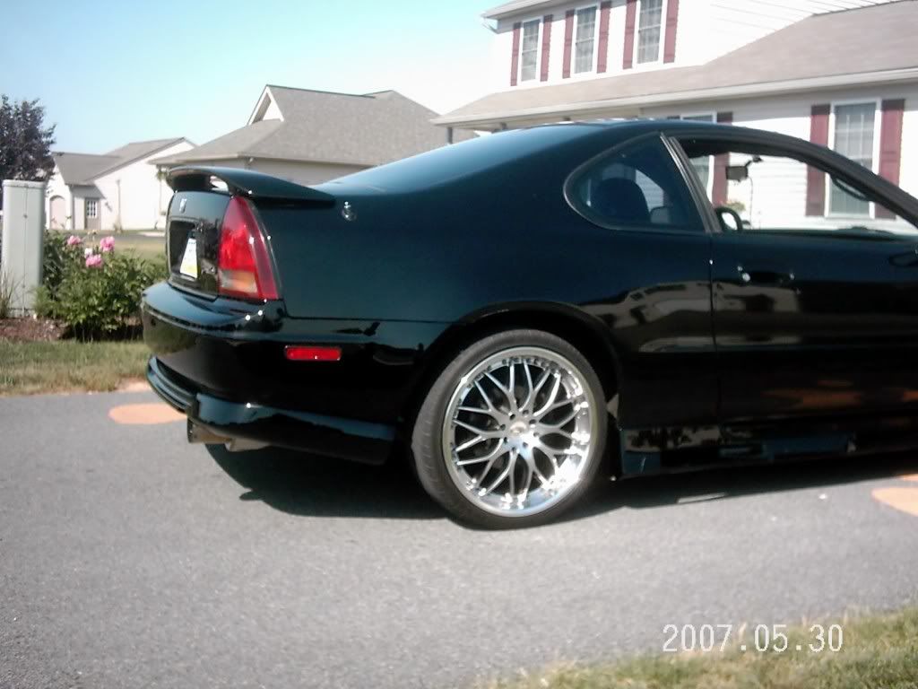

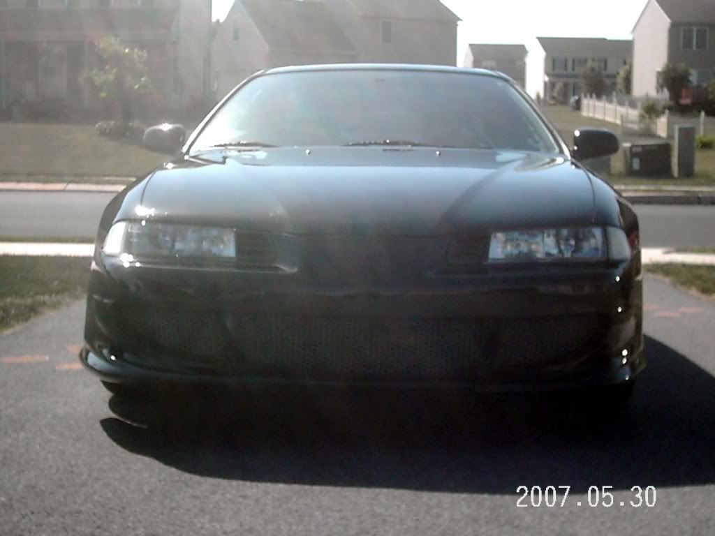

I picked up my lude in 2007 after flipping through the local cars by dealers paper. After a quick test drive I cut a check for 3800 and drove my new baby home. Admittedly, I was all into the Fast and the Furious at the time;
Features on it at the time were;
-Wings West Big Mouth front
-Spyder side skirts
-Wings West rear
-AEM SRI
-unknown brand header (ebay special?)
-unknown brand exhaust with N1 style muffler 2.5" stainless piping
-Venom Performance module
-Non-working alarm system
-Neons  Roll Eyes
-18" HPR Lightning wheels

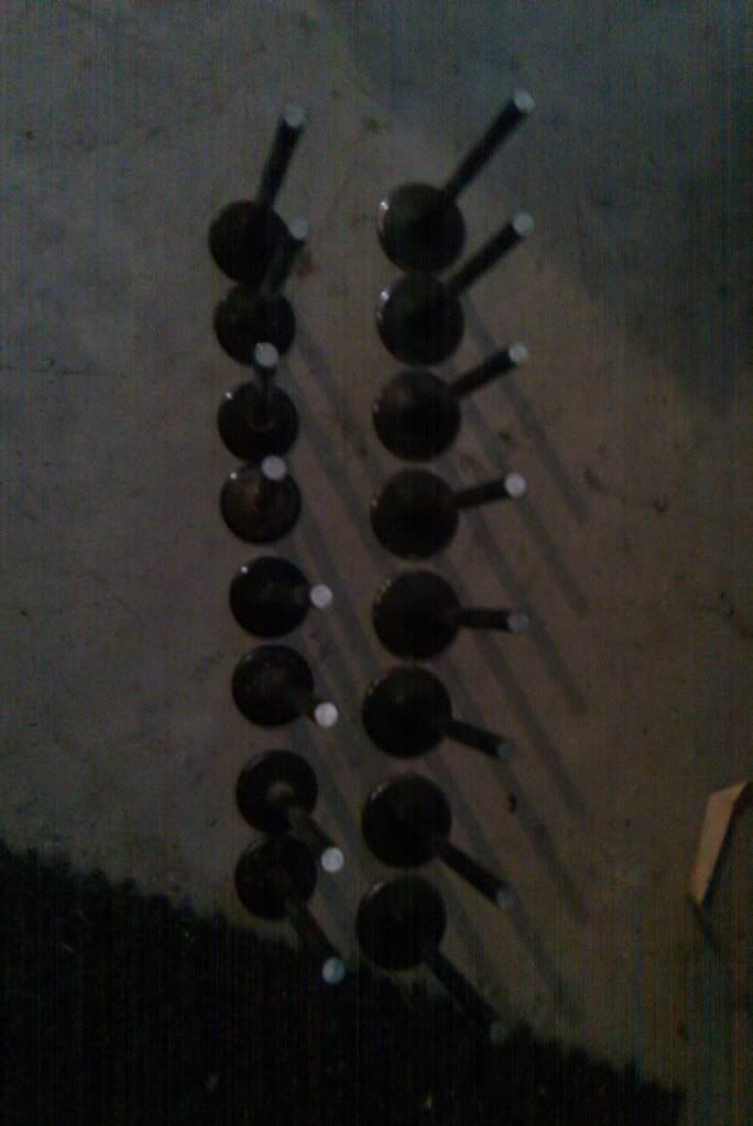

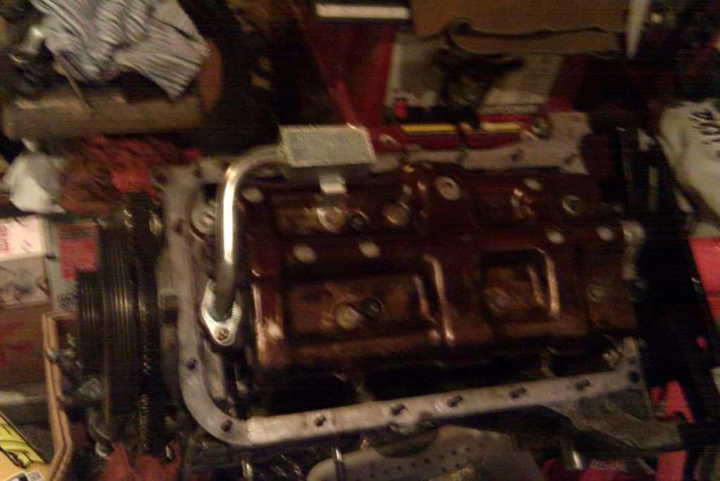

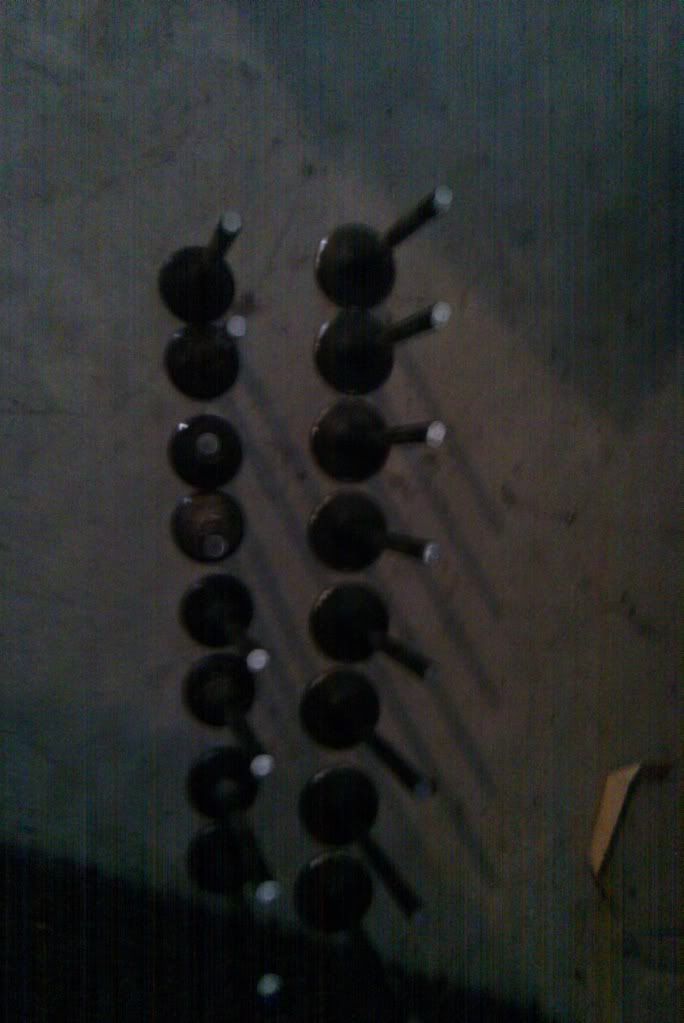

After about 2 months of ownership I suffered a timing belt snapping, so I swapped in an F22B ordered from Tiger Japanese and decided to rebuild the H23.
Aftermath of the timing belt failure;
Two bent valves Sad
Let the rebuild begin!

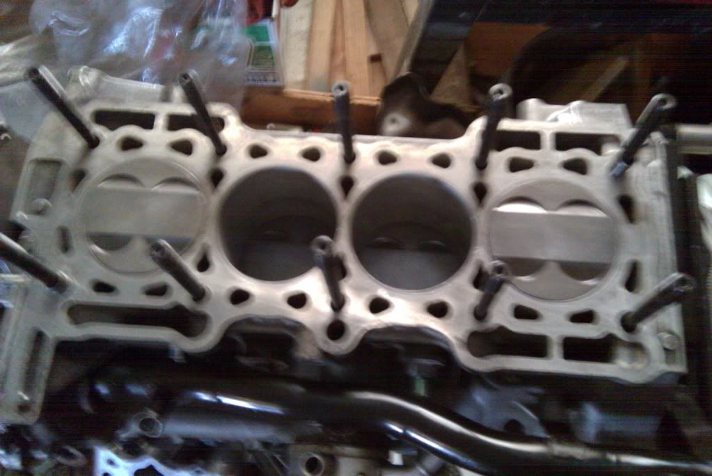

In go ARP head and main studs after the block was hot tanked:
Along with Mahle Gold Series High-Compression Pistons Grin

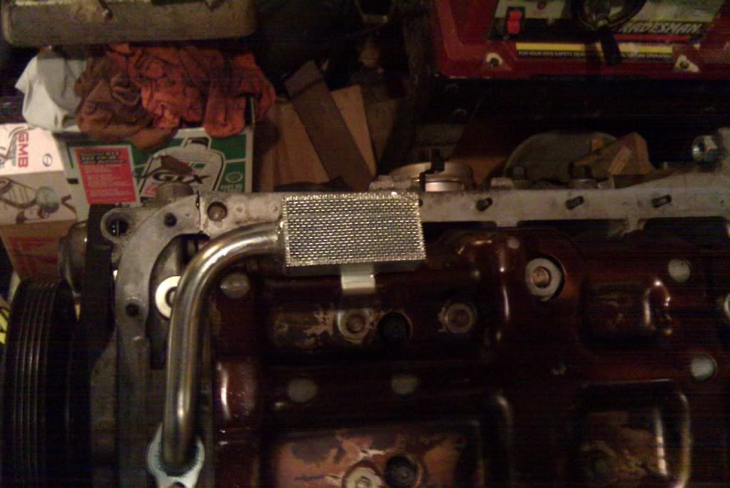

 In goes the Moroso oil pan and pick up

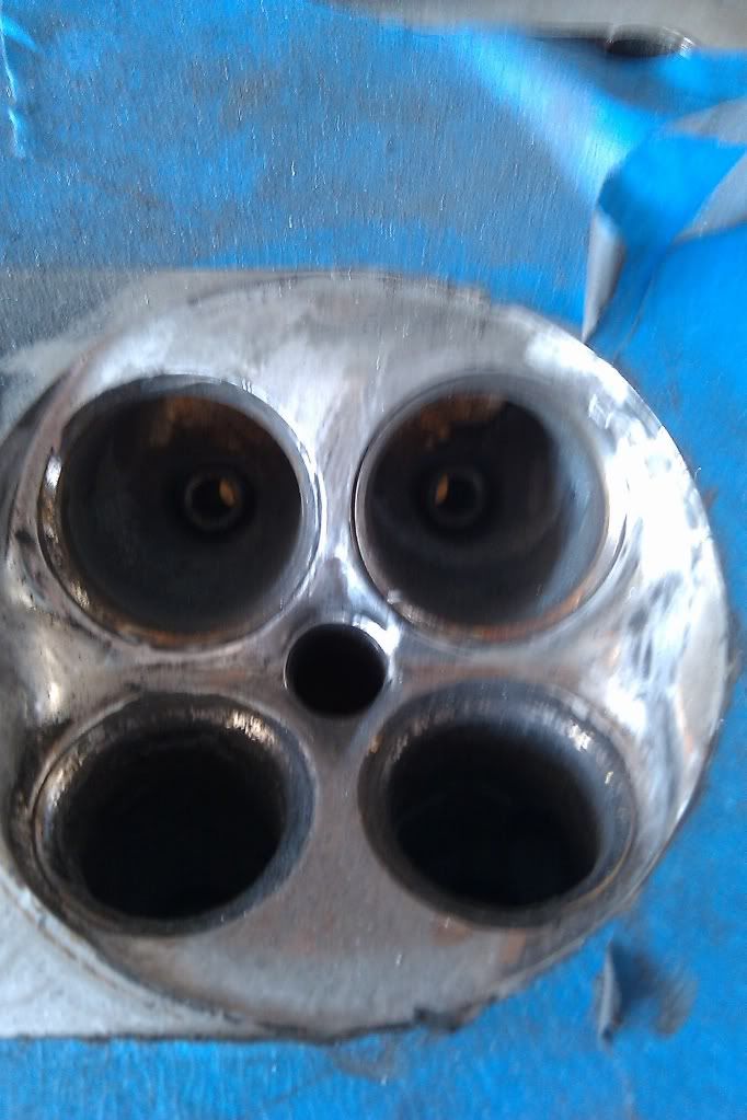

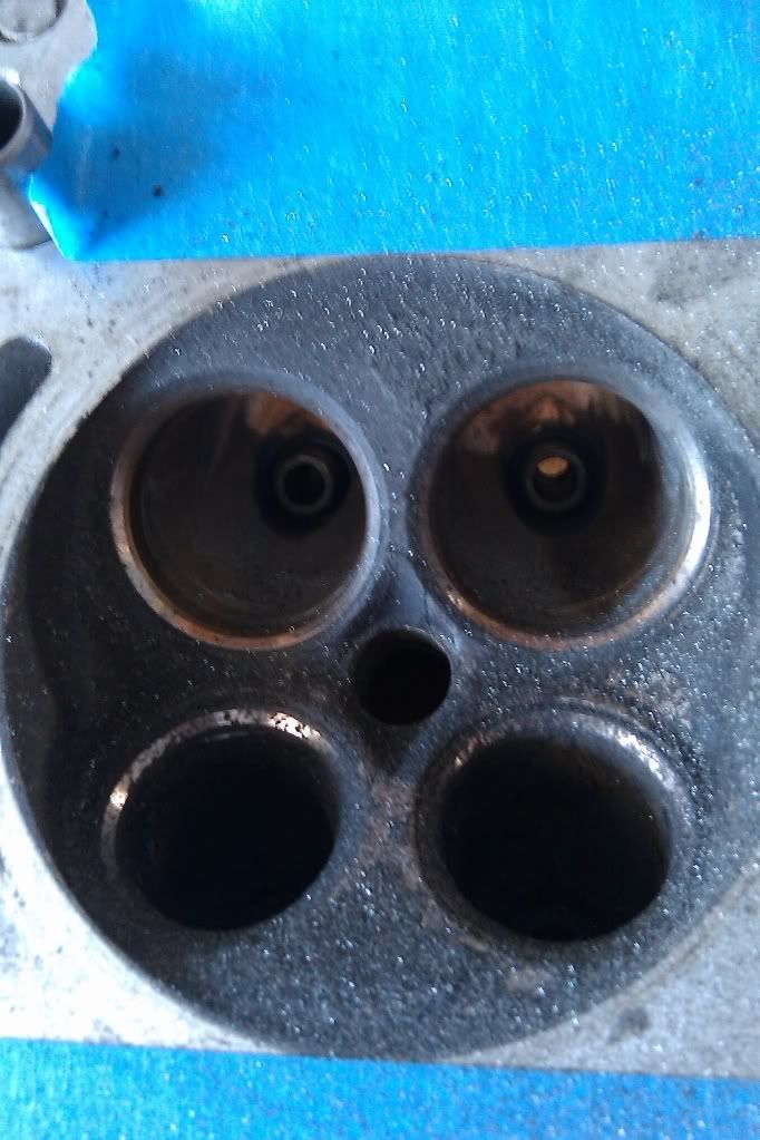

I also cleaned up the carbon in the combustion chamber, not bad for a dremel:
Before
After

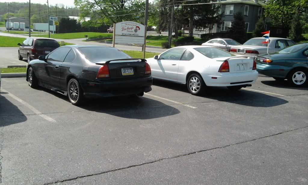

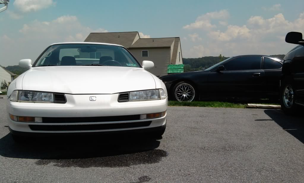

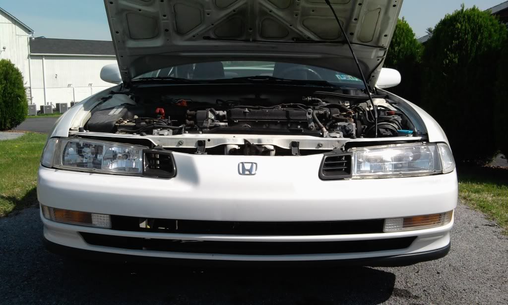

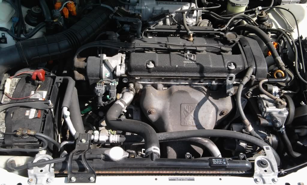

In 2009 I parked the lude in the top of the driveway at my parents house, because I was told it wouldn't pass inspection with the JDM engine in it (in hindsight I now know it doesn't matter, I would have passed). So I then purchased a white 94 si as a daily while I continued the build on the black 94 si. Then life kinda happened and the build was put on hold until recently since I'm finally more financially stable. Anyway, here are some pics of my all original frost white 94 si daily;
Current mods for the black lude are the same as what was on the car when I bought it, but i have added;

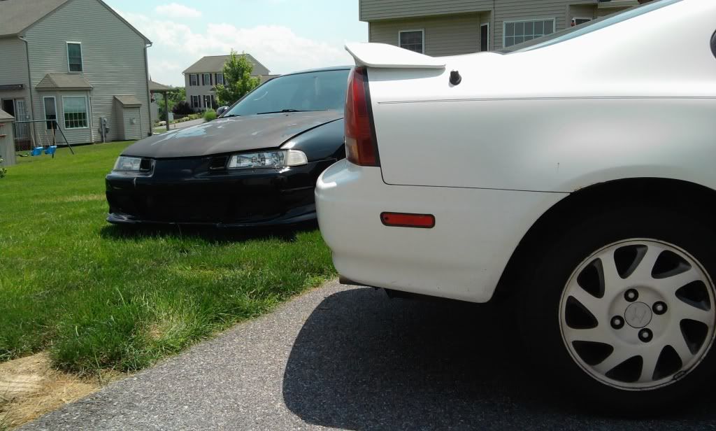

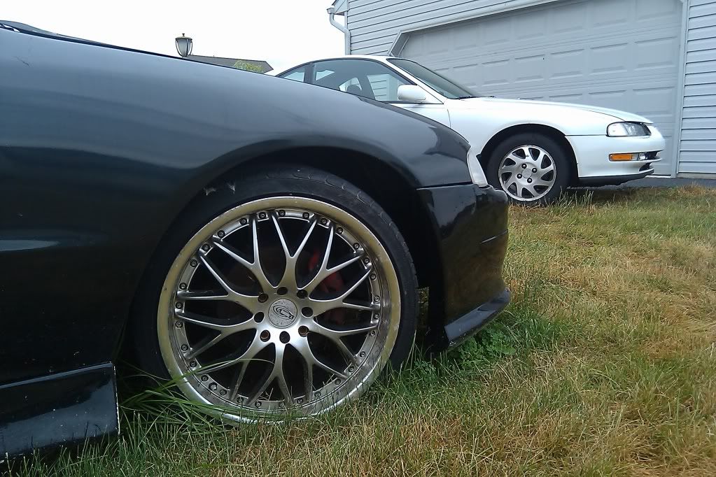

Latest pic of both ludes together, don't about the tails on the black lude I've gotta remove the nite-shade, i was bored...
