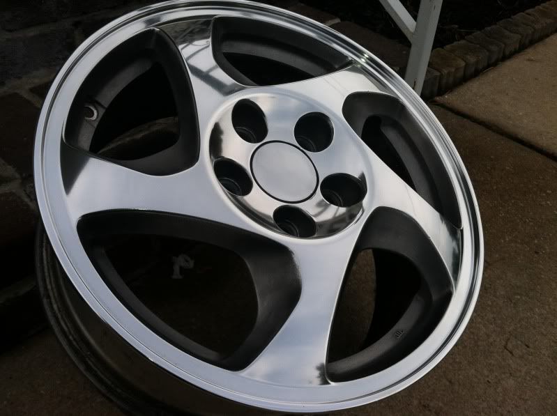

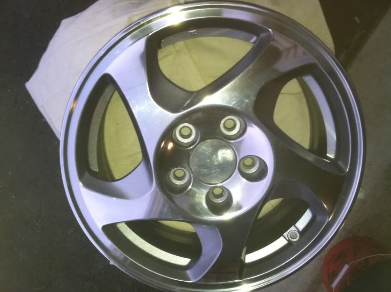

started working on this a while back, finally got the shine I was after. Now for the inlays...
gettin there

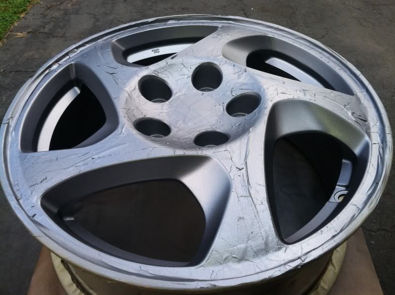

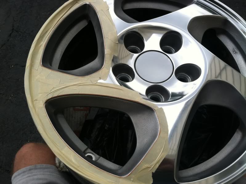

1/16 fine line tape then masked..........takes a while
done!
primer

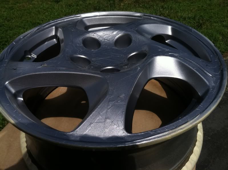

initial color coat
final color coat. clear coat and polish by the end of the weekend.

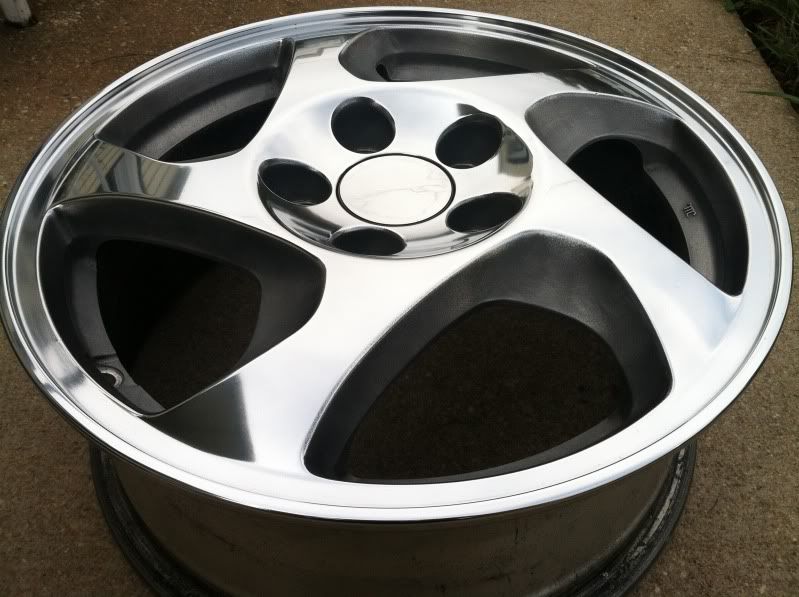

final coat of clear
unmask!
still have to peel the fineline tape
closeup
done...
I'll let the paint cure for a day or so more, then I'm gonna hit the wheel with some more polish and make them shine.
