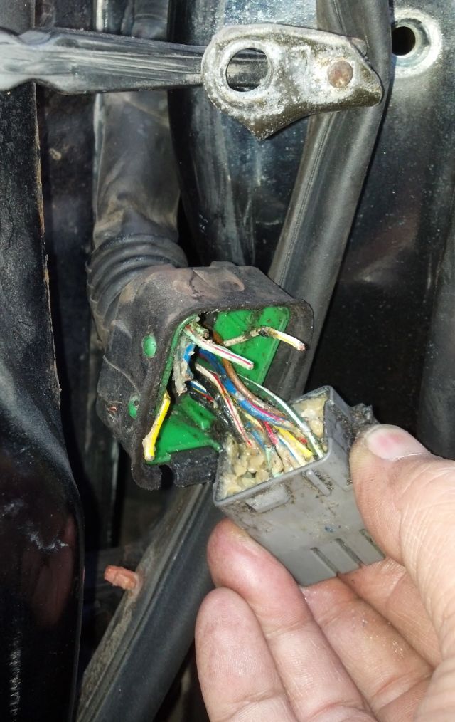

Hollow out the connector and solder new wires in.  Or get another plug/pigtails from a junkyard 'lude Tongue
« Reply #127 on: March 17, 2014, 05:54:35 pm »
http://www.elementownersclub.com/forums/showthread.php?t=11331
Found oem part #'s here... checked majestic and new pins are 20ΒΆ ea...
Weighing my options because I don't want this to happen again.
I considered drilling the connector and running the 20 (?) wires into the door and make either another terminal or 20+/- connections with male/female pins.. I think it's 20, but if not, no biggie, you get  the point.
Whatever I do needs to appear factory with the door panel on the car.
