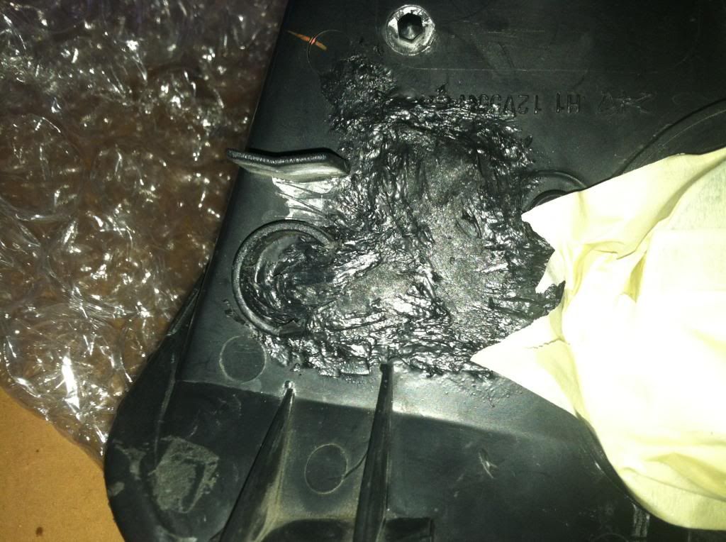

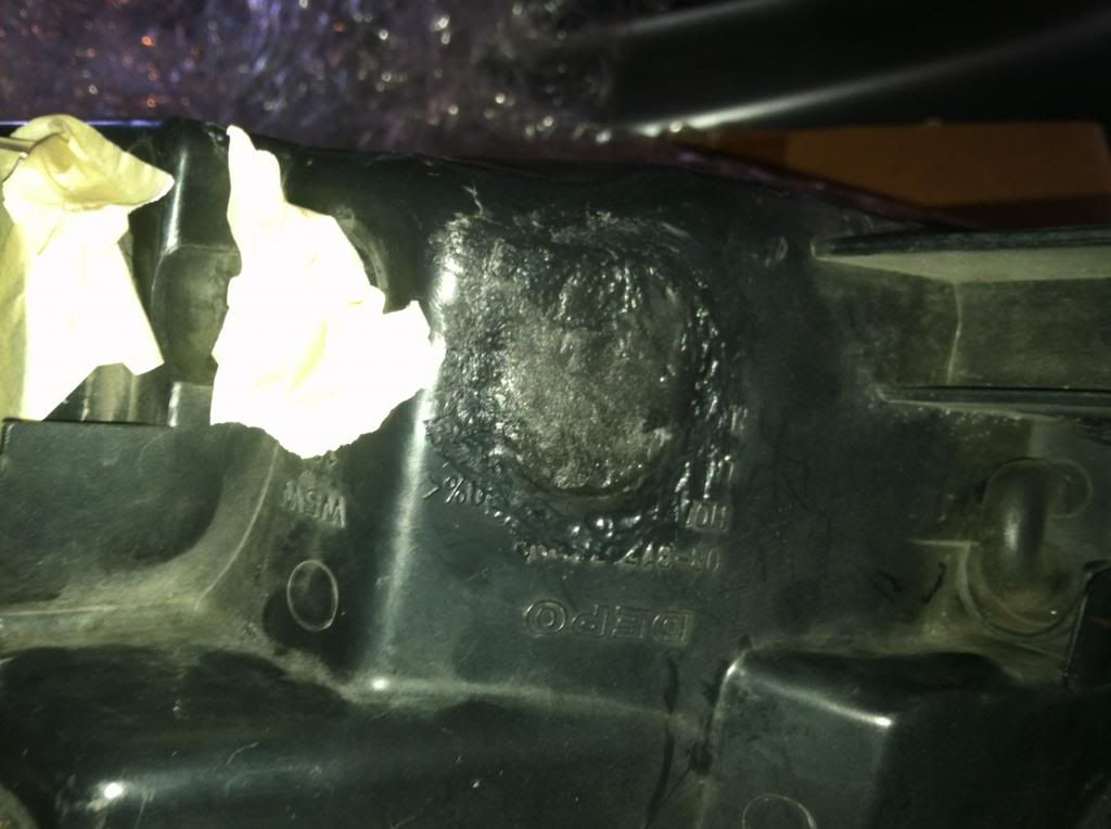

« Reply #16 on: December 13, 2012, 07:17:53 pm »
took pics of the repairs I made on the second head light.
